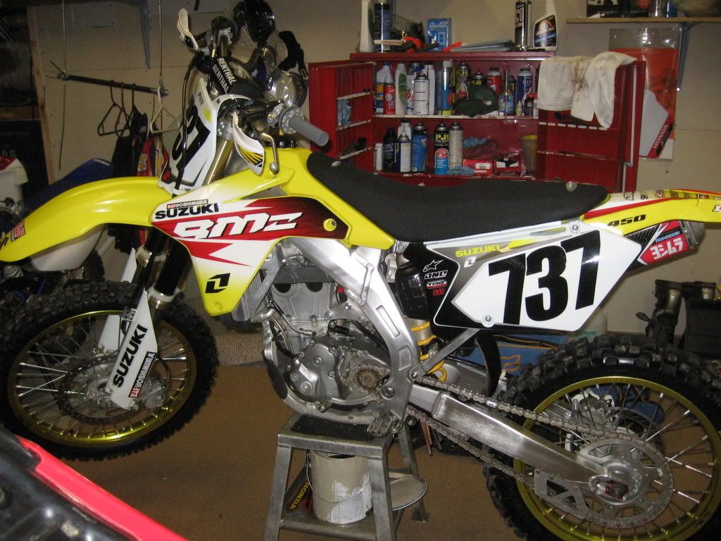

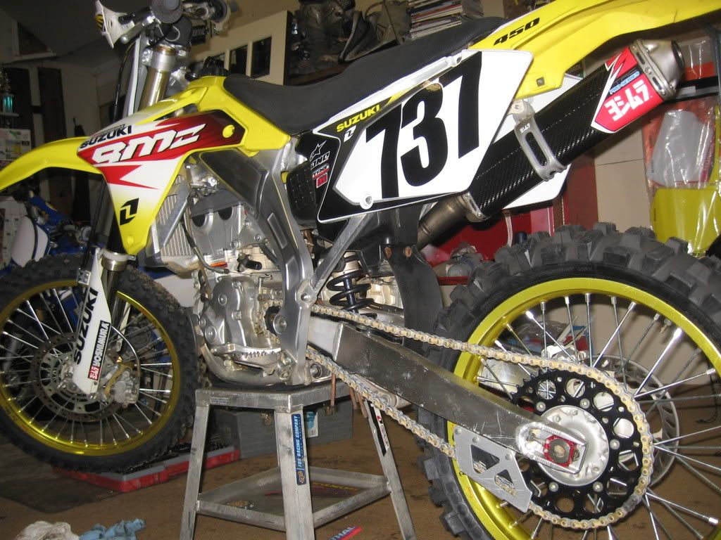

I have the same 05 RMZ 450 now with over 300 hours on it. I change my oil every 2 rides in the woods, or 1 race and or practice day. I have had zero problems with this bike. Ive had the valves adjusted every year, and im truly in a position now where I need to either sell it and buy a new bike, or dump some money into the motor. I dont want to get rid of it because im afraid of buying the wrong "new" bike. If the guy that owned it took care of it, I would buy it. Just my 2 cents. Posted ImagePosted Image
