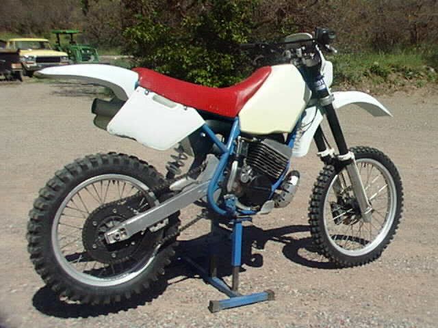

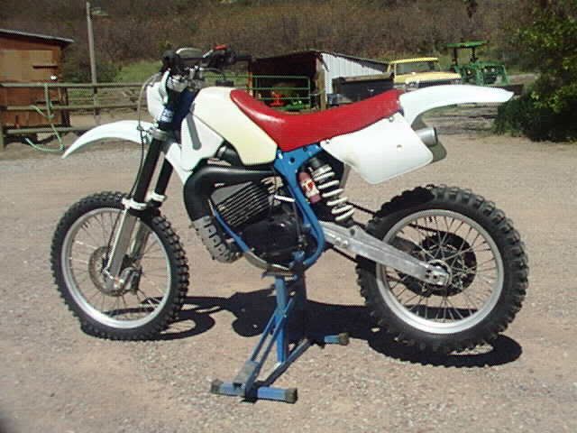

I have a chance to pick up a 1988 ATK 406 for 600 bucks. I don't know much about these bikes but this one has alot of power. It needs a clutch cable and rear brake rotor and brake pads front and back. If any of you guys know these bikes, I need to know how avaliable parts are for this bike and any other pros and cons. I do like the fact that it's american made and from a
quick ride down the road and back it will scream!

Thanks guys for the encouragement. I've always been a four stroker til now but had to add this ATK 406 to the collection. It's a little rough. It needed a clutch cable, rear sprocket, and still needs rear brake countershaft rotor, and
pads. I found Keith at www.americandirtbike.com to be very helpful and lucked out on ebay and found a parts lot that had alot of goodies. I rode it today for a couple of hours with only front brakes. I couldn't resist. This bike is very fast and amazingly light @ only 218lbs. Im guessing I'll have about 700in it by the time I get everything back together. I'll post some pics when done.
