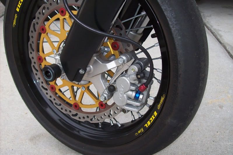

I am using the stock master cylinder with an Earls steel braided line. I also purchased the EBC 320mm rotor that came with the Braking caliper relocater and EBC pads. The braking performance is pretty damn good! More braking than needed really, but like I have said before, I can't help myself. The EBC 320 kit also cost less than the Moto Master 310 rotor.
The really cool thing about the caliper relocater bracket is that it is made out of billet aluminum where the stock bracket isn't. I also went as far as to safety wire the caliper mounting bolts, and the front axle. I'm a huge fan of safety wire!
