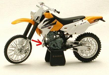

  • xtratoy
Posted June 17, 2007 - 08:41 AM
This is where I have been measuring for comparision.
I'm just trying to find out if the yosh pipes are significantly larger before I install my jet kit, MCCT, and other parts I got yesterday from the TT store. I'll wait to rejet if I decide to Yosh it. 2007 DRZ400S 175 miles on the odometer
  • Eddie Sisneros
Posted June 17, 2007 - 09:31 AM
the head pipe diameter is only a small part of the equation.
  • xtratoy
Posted June 17, 2007 - 09:56 AM
So forget the full system and just do a slip-on ?????? Use the stock small header pipe and and rejet for it?? I plan on leaving the motor S stock except for 3x3, rejet and exhaust. are you saying the yosh upgrade isn't needed? Bike will be a 50/50 street/trail ride.
  • Eddie Sisneros
Posted June 17, 2007 - 10:48 AM
uh,no thats not what i said.
i said the head pipe diameter is only one part of it.there is also length,taper,how much mega phone is built into the muffler.
slip ons make alot of noise and little gain.
  • xtratoy
Posted June 17, 2007 - 11:00 AM
Eddie. thanks for the clarification. :thumbsup:
