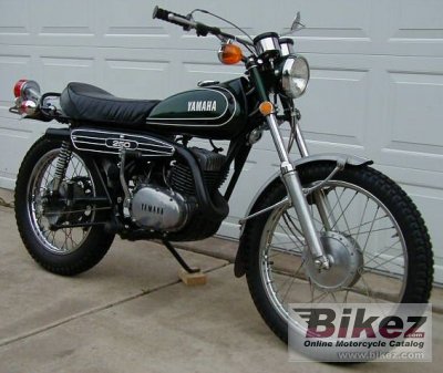

This is my 1971 DT1 which is painted the 1970 Red color.

sorry to thread jack but i have a bike just like that one ^^ but is is green. what year would that be?
If it has the emblems in the tank like mine and it's green it's a 1970 CT1B 175.
If it resembles my bike but has white decals on the tank that spell out the individual letters "Yamaha" and it's also a 250 it would be a 1973 DT3 250.
