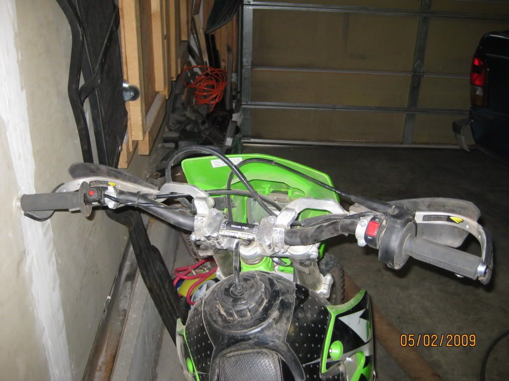

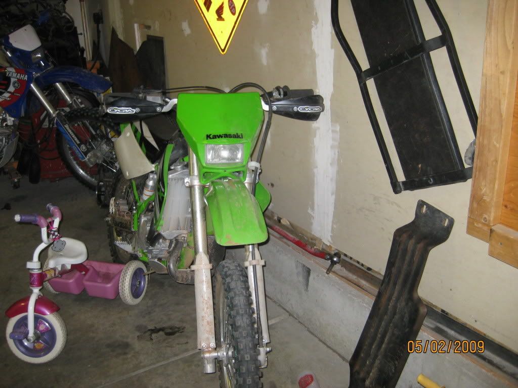

I have had some recent questions about the KDX100 lately, so I thought I would do an update.
I got the jetting figured out on it. Between 2000 and 2002, the carbs changed to a flat slide. I was running way to lean. Now I am running a 42 pilot and a 128 main. That has cleared up most of my issues. I tried to jet it like I had the 2000, and it ended up way to lean.

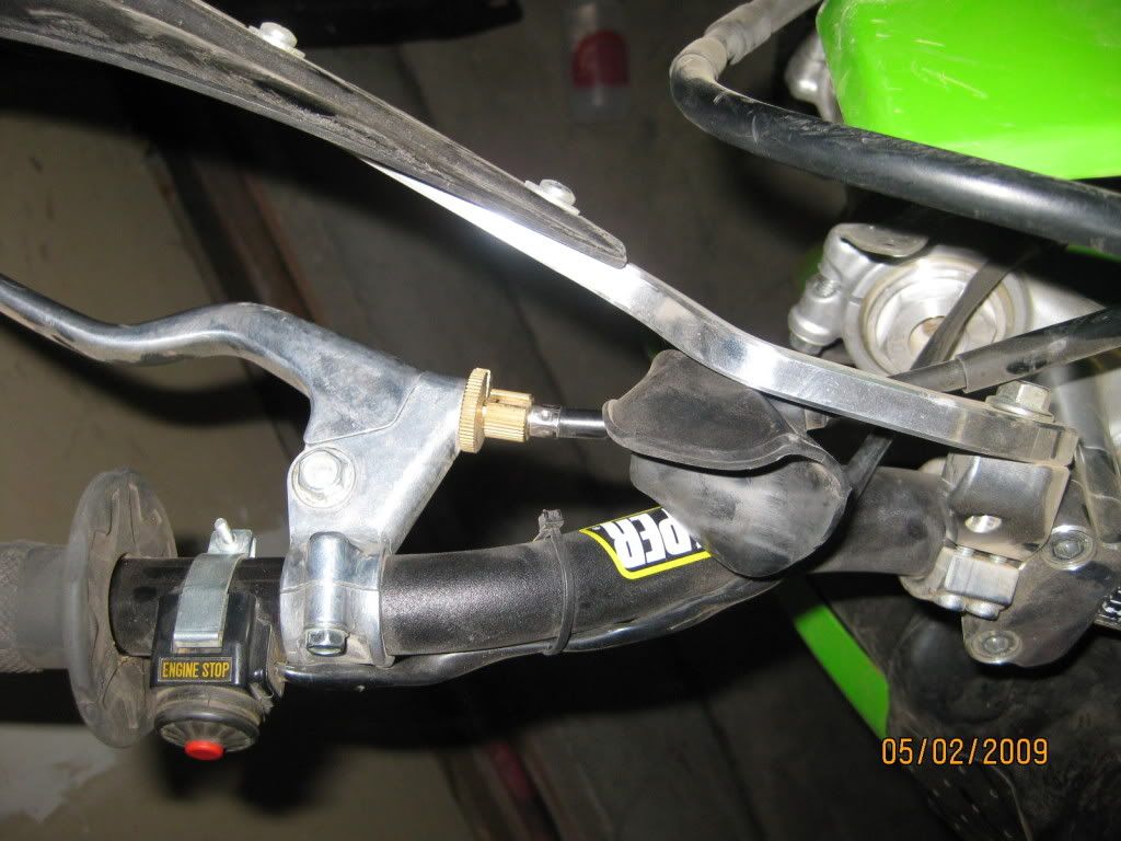

Handle Bars/ Cables. I mentioned I used 2002 kx125 throttle and clutch cables due to the fact that the stock ones were way to short for the higher bend bars we wanted to run. This did not come with out modification.

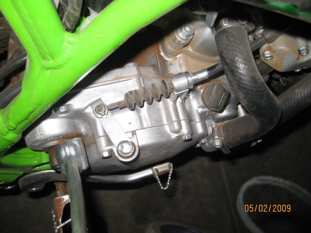

The clutch: On the clutch cable, the lower "cylinder" that acts as a an anchor on the end of the cable was larger on the 125. I considered seeing if a 125 arm would fit into the 100 case, but I eventually just took the easy route and bored out the hole in the arm with a standard drill bit. Seen Here:

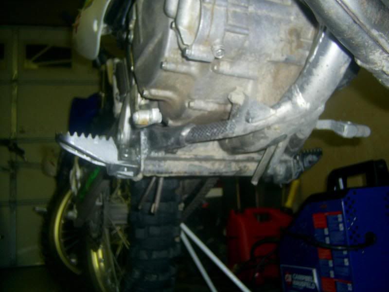

I also ended up grinding down the lever base because I didn't quite have enough slack in the cable to properly adjust the clutch. Seen Here:
The throttle cable mounted up to the carb perfectly, but there was too much cable for the throttle tube. I considered using a 125 throttle tube, but I decided this may not be due to the actual throttle tube, but due to the shorter travel slide on the carb. Anyway, I needed to shorten the cable and add an anchor to it. I cut it with some side cutters and used a clamp on style cable anchor from Ace hardware. Simular to one for a bicycle. I tried using a soldiering iron and melting the factory installed one, but that didn't work at all!
For the brake lever, I used one off a kx250 on the last one and it worked pretty good, but it was almost too long. However, I did have one off my 2000yz426 when I was building the KDX, so I just tried it. It works great Perfect length.

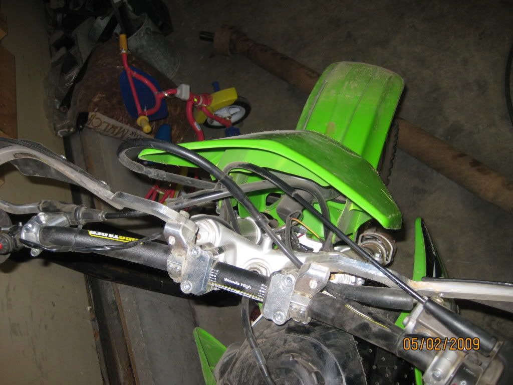

Handlebars: We had ordered some Renthal Mini High bends for it and those worked OK, but I tried to shorten them so my wife could turn easier and stand up straighter (shorter arms on her!) and I ended up shortening them too much. To the point that the brake and clutch perches did not fit correctly. This ticked me off, and they were never really high enough. We went to protapers that I had off my YZ. They were low YZ bends, but we used the cheap protaper adapters that raise the bar 1". Those were close, but still not tall enough. I also modded the Acerbis mini handguard mounts to work with protapers by grinding a little with the die grinder. Eventually the all plastic acerbis wore down and the platic broke from some serious crashes!
The current bars are black protaper "Woods High" bend bars. They are narrower than a conventional bar and they are tall too. She likes them. At the same time I added new Cycra Probend handguards with the new central mounting system. I also swapped out the platic guards that came with the guards for the more low profile set. They are much tougher and with the smaller guards they look more proportional. I also added a trail tech on/off switch for the headlight and  relocated the lisensce plate to the back of the air box. Pics:
I still need to order a steahly kick stand for this one (I sold the 95 kick stand/ mount I built with the 2000) and I am thinking of adding some low boy pro moto billet foot pegs. I was considering doing a piston this winter, but I didn't get it done. Maybe next winter?

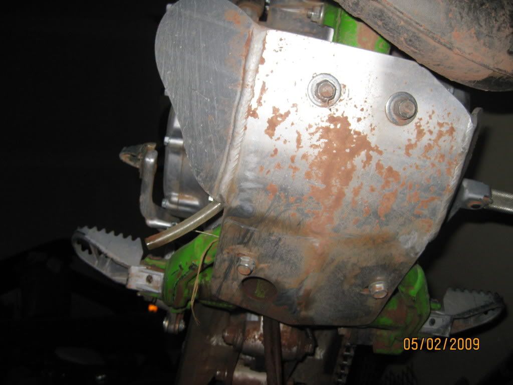

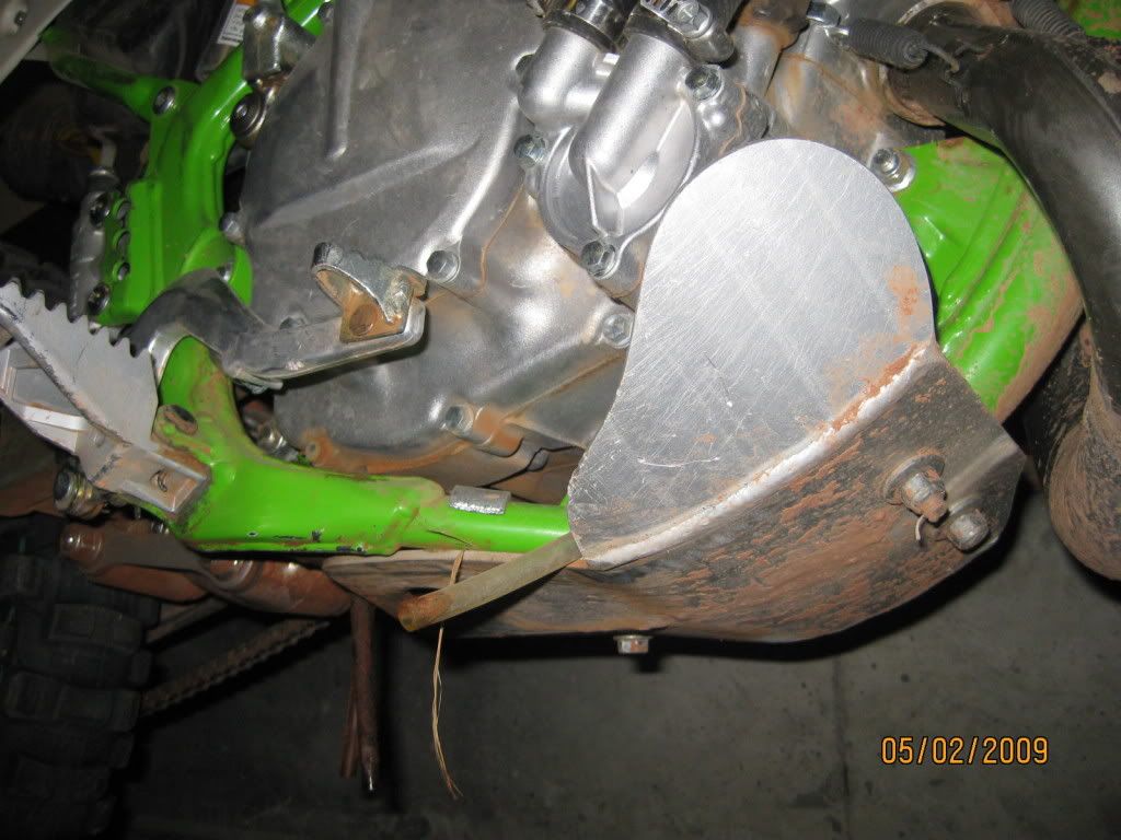

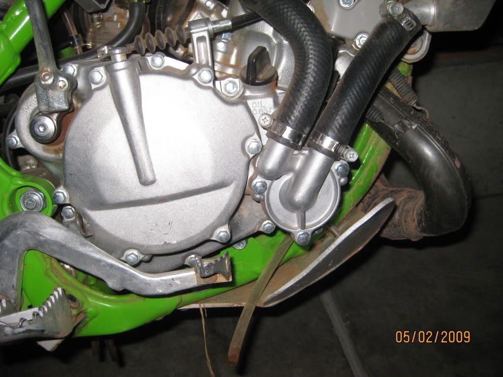

Someone requested close ups of the moose skid plate so here they are:

  • Old-Man
Posted 02 May 2009 - 05:51 PM
#80
Thanks for those pictures of the skid plate. I will order one Monday. :excuseme:
