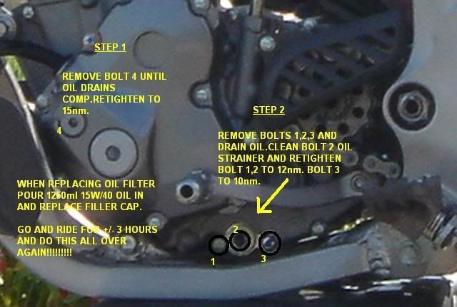

I have a 2007 RMZ450 but unfortunately I don't have the owners manual. Hence the dumb questions I'm about to ask. The engine/transmission oil is all one correct? It's not separate like on a Honda.
Secondly, to drain the oil, do I just undo the two bolts underneath the shifter? There is a big bolt and a smaller bolt.
Thirdly, does anyone have any recommondations for the oil? And what amount do I need to put back in it?
Much appreciated if anyone can help!

yes there is only one compartment for the oil but it needs to be drained out of two bolt holes. there are two bolts under the shift lever but the they are either side of the big bolt, which is the bolt that releases the strainer. i think the oil reccomended by Suzuki is 10/40W at 1250ml or 1300 (i think) after a filter change.

Hi there,:censored: i have made something that could help you guys that struggel with the oil maintenance! Hope this helps!:ride: Posted Image
