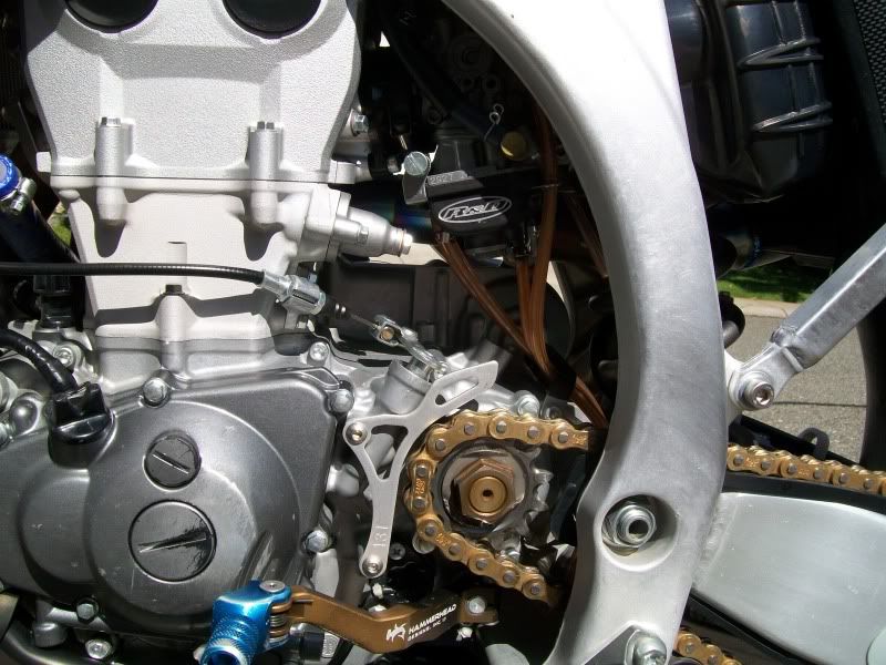

  • Justin89
Posted August 06, 2009 - 07:59 AM
Sorry for the bad pick but you can see it right behing the clutch cable
