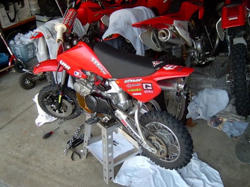

  • perfectlytuned
Posted December 18, 2006 - 05:47 PM
Hey guys. Newbie here. Just started looking into the scene as we picked up a ttr90.
A friend of mine has an XR50R 2002 for his son. He's son is wanting the "look" of the pit bike (on a budget) and isn't concerned with the performance. Atleast not yet. So I told him I'd look into it. What are most guys doing to get these bikes higher? As far as I know all he wants is the stance.. So what are the options without breaking the bank?
Thanks for any input!
extended swingarm, fork legs or new forks all together, maybe a shock. i found a swingarm on ebay for $120, best purchase of my life. haha just watch out for the knockoff parts made for different bikes

  • perfectlytuned
Posted December 19, 2006 - 11:51 AM
i bought this swingarm http://cgi.ebay.com/...063259005QQrdZ1
it came as a 50 caliber swingarm and so far its been great
i bought a staggs shock which is decent and found my forks on ebay
u dont have to spend 1k... u will need a new chain tho and a chain breaker to cut it

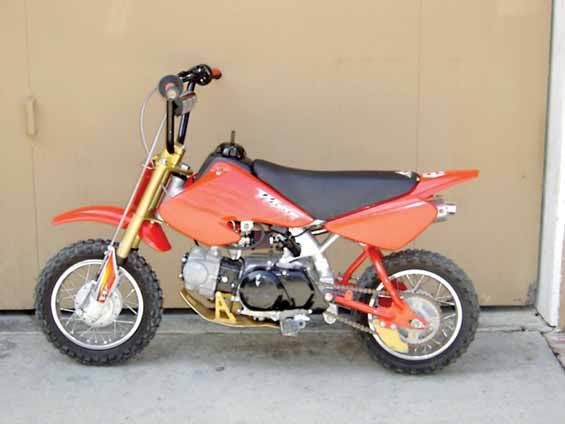

  • kashlak
Posted December 19, 2006 - 04:53 PM
http://i65.photobuck...shlak/crf50.jpg
pict of my bike with front fork extenders and HD springs obout 2'' of lift. Rear has 10.5'' ishock for 2'' of lift.

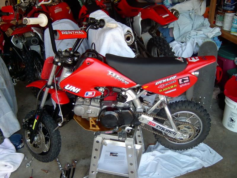

  • perfectlytuned
Posted December 19, 2006 - 05:55 PM
Do you have another picture of the bike from the side view?
I've checked out stagg's site and it seems like the parts are resonably priced, are they of good quality? How is the mono swingarm kit with shock? This seems like a great kit for the price.
Depending on what you say about the mono swingarm what about the extending kit they offer for $145? It uses the stock swingarm and shock but offers 3.5" of lift?
Or would I be better with an extended A-arm swingarm like the 50 caliber with a shock or extend stock shock?
For the front I'm still a bit lost. It seems my only options are the 1" extended fork tubes, do I need springs for this? The rider is a small boy. Is this high enough?
The front forks from staggs for $250 look like a decent deal. I may beable to find some cheaper on ebay but how does the quality differ? Do the staggs forks or any aftermarket forks offer more lift than the extended forks? And I assume I need to get new bars for the forks?
Thanks again guys!
people dont like 50 caliber but there swingarm is great. anythin else i probably wouldnt buy from them tho. i think they make +2 fork legs not just 1
heres it when i bought it
heres it now from the side (u can see the difference)
