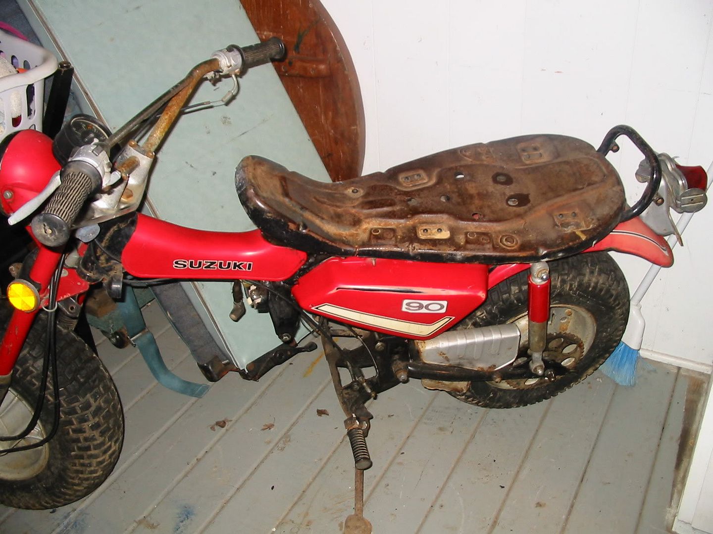

On Aug 05, 2008......I bought this basket case. I finally got it to move this past weekend.....and boy did it!
My number one problem was the spark, and a dirty carb. I had to glue in a new coil wire to the coil, then cleaned the carb better. I had to steal a control cable from a push mower safety engine cut-off lever....to use as a clutch cable, I greased it and thread it through the RV90's clutch cable jacket, made some rough adjustments......wallaaa.....a working clutch! I ran it in the woods to break in the new rings for about a hour or so.....what fun. I tested it's top speed on a flat.....37 mph without tuning. Next is a new spark plug, fix the air filter, fixaflat in the rear tire, or new tube. Then beautification....:thumbsup:
I'm running 3/4 quart 10w40 in the transmission
50:1 Premixed oil in gas tank,
Oil pump is still hooked up, with 10w40 in tank  (my oil pump is not working correctly, I want to unhook the oil line from pump to carb, and just run oil from the pump to engine case, I like the idea of mixing 50:1 for insurance)
Pictures to come.....

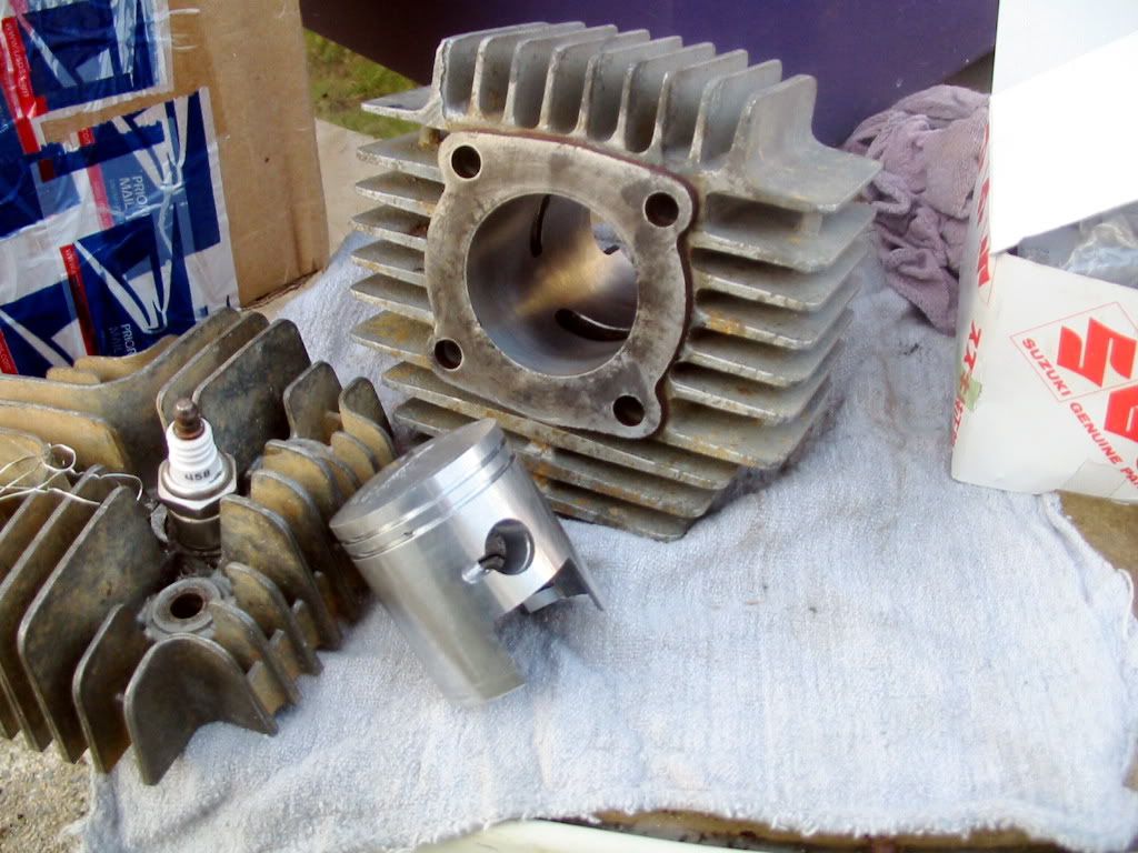

GYTR said:
Hi I am new to thumper talk but have an issue with my 1974 RV 90 and was hopping you may help. The issue is I have a lot of oil coming from the exhaust it runs and idles fine just have a lot of smoke at full throttle. I have the owner’s manual but it is not to clear on the oil pump settings. The bike has been sitting for 5 years before I got it started so it may just be bad oil or gas I have placed new gas in it but mixed with old. It has what I would say is oil splattering on the rear fender. I also have a RV 125 and it is not having this issue so any help would be great.
Typical of OLD two strokes it sounds like your crank seals are bad. So its sucking tranny oil into the crankcase.
I know its an old post you made, but no one answered so I thought I'd toss in my .02 worth.

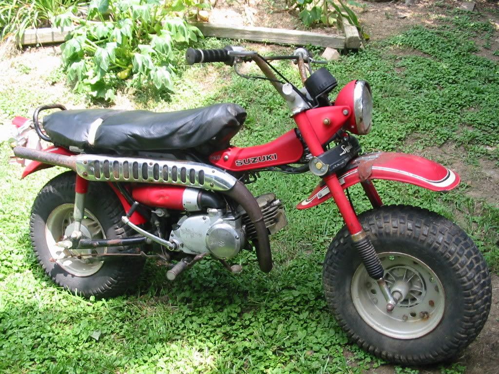

Here is some pictures taken while I was recovering the seat with a old "Members Only" jacket...you can see that rigged airfilter.....it is just not cutting it, I start to overheat after about 30 1 hour into my rides.
http://i196.photobuc...orte/foamer.jpg
http://i196.photobuc...te/DSC02810.jpg
Other than that it runs great.....stuff keeps breaking like:
speedometer cable snapped
slipping clutch
no lights
no battery or working charging system
leaky tire tube
chain adjusters are toast- ordered new parts
engine case bolts are all miss-matched
no chain guards...eeeek!
exhaust manifold has a stripped thread on head, needs retapped.
It is a blast to run in the woods, but it handles loose, I layed it down once because it squirreled out on me coming out of a ditch.....but it was graceful....I'm glad it was not a bigger bike I might have be hurt if it was....
Good luck on your RV90! and post some pictures........
