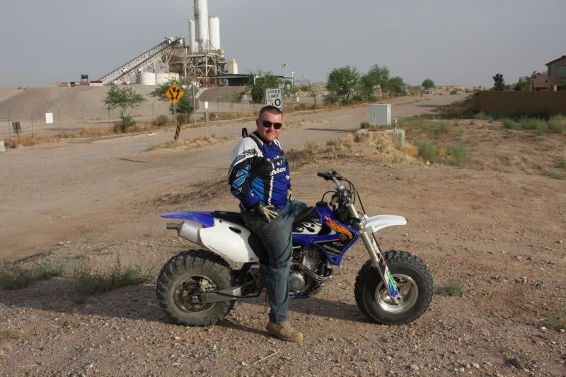

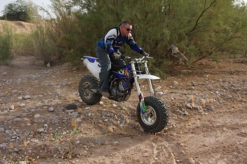

I made a Yamaha 450cc Big Wheel. Its actually just a bolt on kit that takes about 30 mins to go back and forth from factory to big wheel mod. any questions usmcjordan@yahoo.com

22 posts
Location: Arizona
Posted 08 July 2011 - 05:43 PM
Well basically I made a custom swing arm, hud, and clamps. The parts use factory brakes and sprockets, so this is a bolt on kit that you can go from factory to big wheel mod is about 45 mins. The integrity of the bike itself stays the same. If you want more details just email me usmcjordan@yahoo.com
