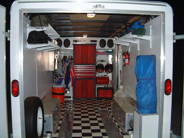

Just found these pictures that I had. They were originally posted by someone that I know on another MX forum. I still have his original quotes/description too:
Quote
Here is the view from the rear...note the things along the sides are water tanks, not fender wells (this is a 6x12, the wheels are on the outside). In front of the orange water jug is a box that contains the AC/DC distribution panel and converter/charger.

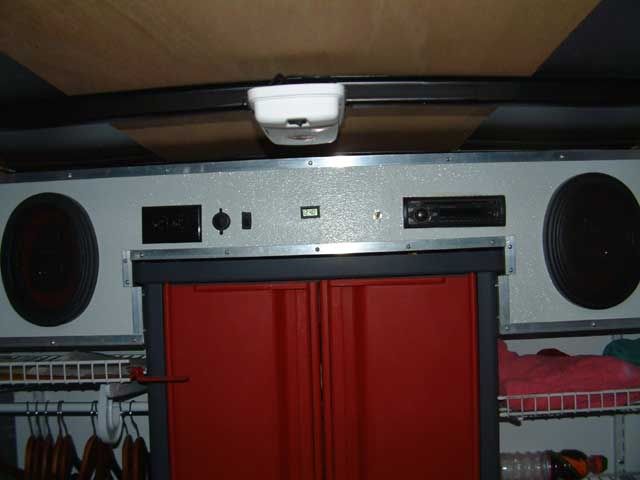

Here is the console I built that holds a Sony CD player, 4-6x9's, AC outlet, DC outlet, and a small LCD panel that monitors the charge left in the battery.

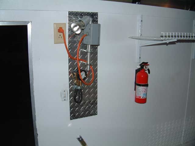

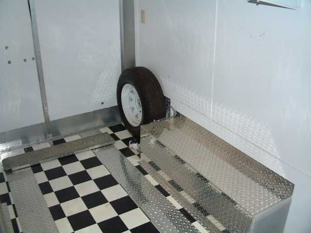

Here is the right tank and the gas can holder I made.
Quote
Here is the left 30 gallon tank and the spare tired I bolted to the wall.

This is a really cool light that my buddy made. It hangs in this holder that I made until I need it outside at a night race, the I lift it out and drop it down into the hollow bar thing that latches the door shut and it will twist whatever direction I need it (I can also remove it and use it at the back door)

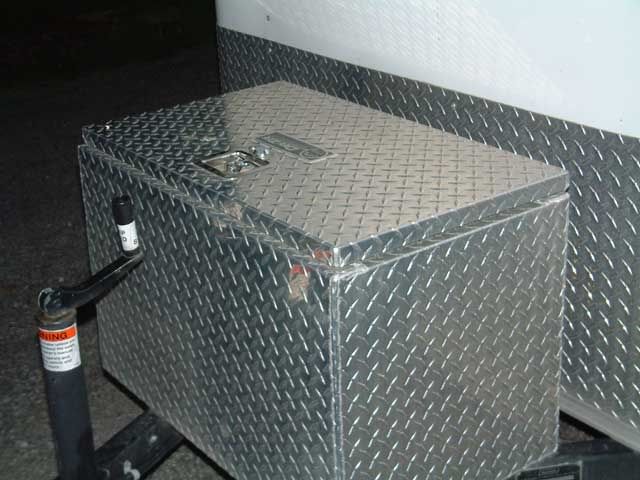

This is where the deep cycle battery is located that powers the 12v stuff in the trailer. I also throw air filters, hoses for pressure washer etc. in here.

I just have a single group 24 battery that I pulled from my motorhome (when I switched it to 2-6v's in series). Basically all I run on it is the small ceiling lights and the radio. I would imagine it would run a VERY long time, but at night races I generally plug the trailer into the generator on the motorhome and the converter/charger that I installed in the trailer has a 3-stage smart charger built in that tops off the battery.
The CD player and speakers are mounted in a box I made out of partical board and then glued the white FRP (Fiber re-inforced paneling..available at lowes or home depot) and trimmed it out with aluminum angle. The power comes from a 12v battery mounted in the diamond plate toolbox on the tongue. It is fed through conduit under the trailer then up through the floor into and RV AC/DC distribution panel (it has AC breakers on one side and automotive fuses on the other side). From here each AC and DC circuit is on it's own fuse/breaker.
Also I didn't mention how the water tanks work. They are RV fresh water tanks that I covered with diamond plate for protection (because they are very thin). The 1 1/2" plumbing of the tank goes through the floor into a tee and then out a spigot on the drivers side. The tanks are "backfilled" through the spigot... that is what the vent hose out the top is for. I also put valves on the vents so water doesn't splash out or leak out if stopped on a hill.
