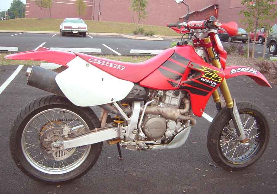

If you use a Koubalink do you lower the front end as well. Can someone give me some feedback on this product. Just need to gain a few inches but hate to mess with the factory specs. Thanks

Just installed the Koubalink. I have a short inseam and the link really helped. I did lower the forks 1" from the top of the triple clamp to the top of the fork cap to balance the bike. It rides just as good as the full suspension only shorter. I ride the bike about 40% road and 60% trail and woods. It still soaks up the bumps and crosses logs with ease. Other than lowering the forks and installing the link there are no other suspension mods.

I've been using the KoubaLink to lower the rear end of my motard XR650R. I pulled the forklegs approx. 1 1/2 inch up in the triple clamp to even out the bike. Excellent product IMO. :cry:

Caution! It might be possible for the tires to hit the underside of the fenders. If you drop the triple clamps too much it wouldn't be nice if the front tire scraped the fender hard during a high speed G-out (like locking the front brake at the worst possible moment) The only way to be sure it won't scrape is to pull the fork caps, (bars, etc. if they're in the way) and let the front end down to full fork stroke and check for enough clearance.

We saw the koubalink but it is for the rear lowering and we have already dropped the triple clamp as much as possible. But it is not enough.
Are there any way to lower the front by using spacers for springs, revalving etc?

http://www.thumperta...ad.php?t=398279 read this about lowering links, worth the thought. I think the Kouba link has a disclaimer about lowering the front of the 650r more than 1 1/2".

I've read this article, now I'm confused. Because my friend rides in enduro and motocross races in amateur category. And in the article it is written that the lowering links are not suitable for motocross riding style.
Also my friend told me that he wants to change the wheels of his crf 250x with youth bike wheels (16 inch x 19 inch). It sounds weird for me but I dont know any negative effect would appear...

I guess it just boils gown to how hard you ride and tax the suspension. I had the K link on my DR and had to go up a few spring sizes to keep from blowing through the stroke. Kouba did the suspension on that bike also and it tracked fine but required a stiffer spring.
