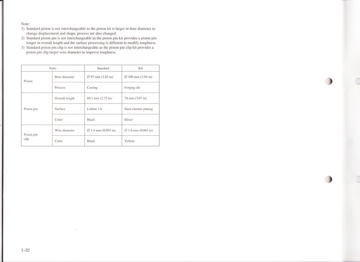

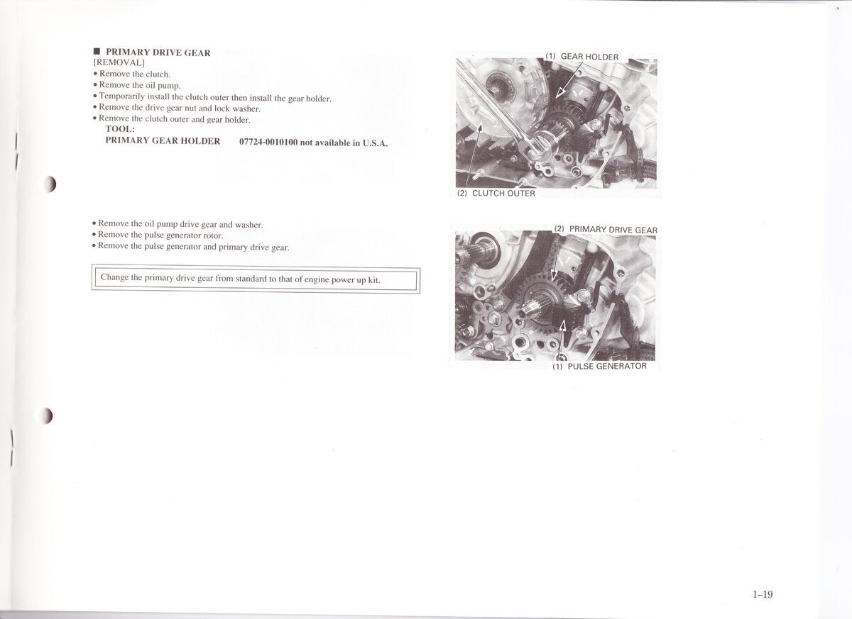

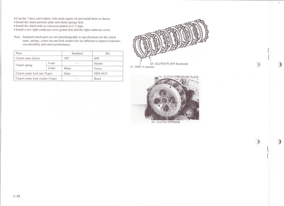

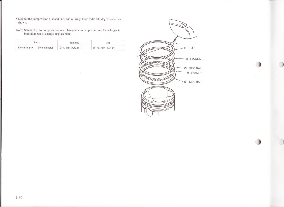

I don't have the exact dyno details handy, but I believe the HRC cam is more of a mid range cam that also shows some improvement in the top end. I've read where team Honda often uses the HRC cam without the high compression piston.

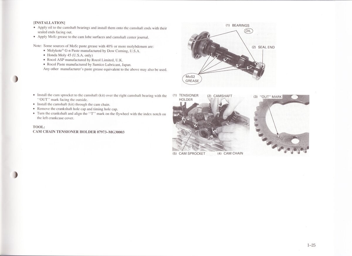

The HRC cam PN# 14000-NLB-000 is rather costly at $526.13 and requires the use of the HRC cam chain PN# 14401-nlb-003 which has a retail price of $120.98. You'll also need the timing sprocket PN# 14312-nlb-000 which carries a retail price of $100.51, a cam sprocket PN# 14321-nlb-000 which also retails for $100.51 and the tension lifter assembly PN# 14520-nlb-003 which also happens to retail for $100.51 :cry: If you don't mind living without the auto decompressor, you could buy a HotCam for ~$150 :cry:
Here's part of the text from an interesting article concerning how the Honda Off Road Team builds Baja bikes.
http://www.hondaredr...&Type=OR&bhcp=1
An HRC Power-Up Kit (available through all Honda Dealers, Part Number 06130-NLB-010) is the star of this show, but many times the team will elect to use only a portion of the kit. The kit’s heavy-duty clutch springs, cam chain (plus corresponding sprockets and tensioner), high-performance cam and appropriate jetting (as well as additional breather holes in the airbox cover—though the stock filter and backfire screen are retained) are used for all events. The kit also includes specs for an exhaust system, and Pro Circuit’s full T4 system complies and is used by the team.
When conditions demand more power, Campbell employs the kit’s high-compression piston as well as minor porting of the head to help bring out the optimum power characteristics for specific racing applications. Unless the high-compression piston is used, however, the team runs stock porting.
“We really like the way the engine runs using the stock piston and stock compression,” says Campbell. “We can run that motor for tens of thousands of miles, no problem.” And with 15/47 gearing, compared to the stock 14/48, Campbell’s Baja bike will nudge 115 mph.
“It’s a pretty simple engine package,” he points out. No balanced cranks, no shot-peened gears or other tricks are necessary. “The bike’s proven itself over and over,” says Campbell. “The bottom end was built for more than 70 horsepower, and we’ve never been able to get that much out of our bikes,” he laughs. (Campbell admits to getting 60+ horsepower out of the full-kit motors.)
