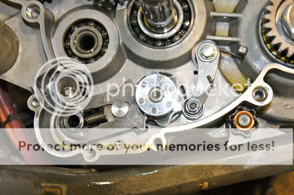

Our local Colorado speed shop LSE (Leavitt Speed Equipment
http://lseracing.com/) developed a repair that has successfully fixed
this issue on all four bike. It included polishing the SHIFT DRUM and
replacing the wheel on the LOCATING LEVER with an actual bearing.

Next time you have one apart can snap a picture of the modifications and post a picture. I have experienced the same problem. When under hard acceleration second to third won't shift. Even pulled clutch in and tried shifting but can't feel the click of third gear and when releasing the clutch it is still in second of course. During the shift and clutch pulling I am not letting off the gas, just holding it on.

Here's a photo of mod. note the locating lever wheel has been changed to a bearing. The bearing moves over the drum smoother and progresses into the drum indexes with less residence. I have heard that the slide plate spring is weak and folks have modified it with some success. We choose to remove KTM's wheel and replace it with a bearing and polish the drum surface. Now after a month of riding none of four riders have had any issues with 2nd to 3rd hanging up.

i thought the stock lever arm did use some sort of bearing ? if you look it appears to be a ball bearing http://www.ebay.com/...1485c2b&vxp=mtr

[color=#222222][font=Helvetica Neue', Arial, Verdana, sans-serif][size=4][background=rgb(255, 255, 255)]KTM uses a wheel that rides on an axle. I replaced it with a true roller bearing. [/background][/size][/font][/color]

maybe they changed on the new bikes. they were using a ball bearing style like the link i posted
