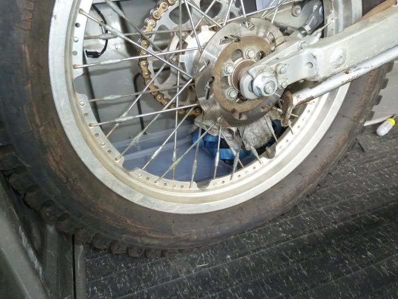

X11 is a Michelin radial ply tubeless competition Trials tire, 4.00R18. Here is a video of why it works so well. http://home.comcast....-tire-test2.wmv
Low TP usually means tire slippage and a torn valve stem and/or the bead not staying seated against the rim flange which creates handling issue and potential rim damage.  IMO the best solution to running low TP with a tube rim is the Tubliss system because it keeps the tire bead clamped tightly against the rim solving both problems.   I have several, front and rear,  and they work great.
Bead seating a tubeless tire can be very difficult on some tube rims because of the bead differences, I have an early eighties DID rim that is a problem and two other later DID rims that are not, Slime can be your friend.
Tubeless rims used on Trials bikes are different from tube rims used on other dirt bikes; the tire beads and rim beads are different  and they don't use rim locks yet the tire beads stay against the rim flange and the tire doesn't slip.  Tubeless spoke rims use two methods to seal the spokes; one use a seal liner that fits in the rim drop center, and the DID rim with no spoke holes.
So we have tube and tubeless tires, tube and tubeless rims, run with or without tubes;  low TP or not: Too many combinations for simple answers. But to your specific question for your XR200: IMO the best option for running low TP with a Trials or knobby is with a Tubliss. Second if with a knobby get a HD tube and add a second rim lock. I have used D803s and Tubliss systems on three bikes, on one I currently run Tubliss on the front with a knobby.  The Trials bike rim is an option but the Tubliss is easier and very much cheaper.
X11 on tubeless DID rim. The low pressure is from riding wet clay last fall, I need to check pressure before the next ride.
