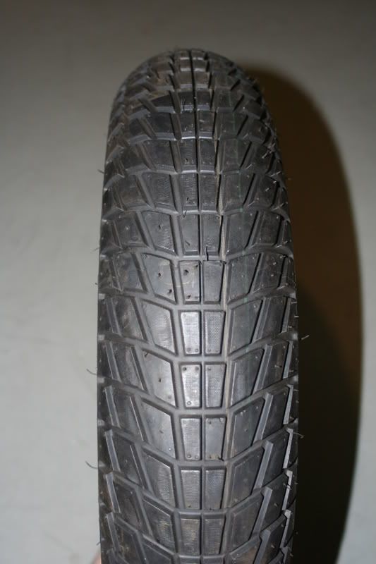

On a smaller bike like that the 17" rain slicks are the hot ticket like the pirelli Diablos or some other brand in a 120/80-17 or 120/70-17 something like that .
something like this. they fit nice on a modern sport bike front rim 3.5x17" . If you were running a rear disk and got a bit creative with a lathe to make some spacers you could mount a disk on one side and sprocket on the other side.

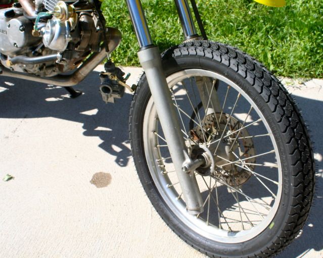

something like this only not with a nobby

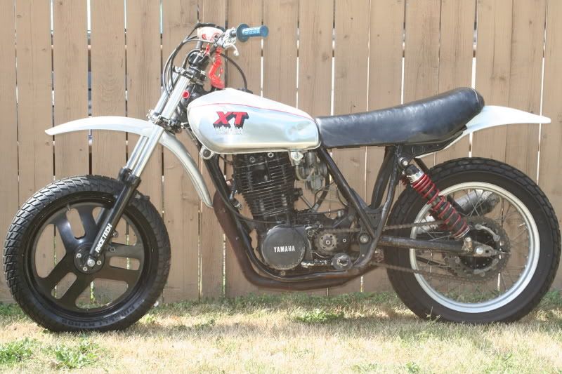

they're too small on the front of my XT500 but they will find there way on to my DRZ125 sooner or later.

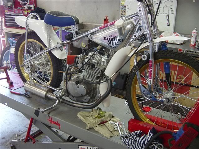

I haven't seen any after market frames for the little Suzuki, whether from Knight, C&J or Champion. I honestly doubt any were made, but I DO know that someone built some speedway frames for the same motor! :devil:
Like this ? You should look him up maybe he'd ship one over from OZ Posted Image

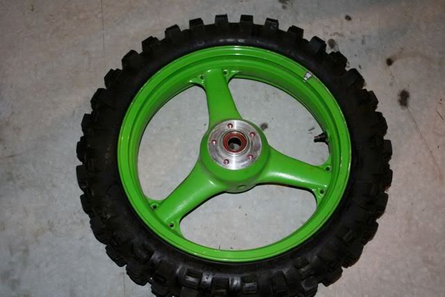

I thought I had a 17 inch front, but I can't find it anywhere. If I could find the spoke count for the DR125, I would delace my spare rear wheel and pick up a RM80 front wheel, and lace the two together for a front. The rear wheel will probably end up being a 98 RM125 hub laced to a 3.5 supermoto rim. I totally forgot I had that wheel!
